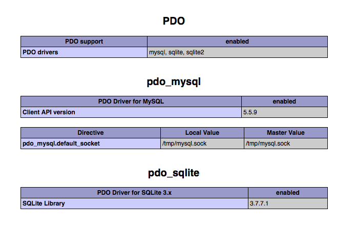

From phpinfo:
'./configure' '--with-apxs2' '--with-curl=/usr/local/lib' '--with-gd' '--with-ttf' '--with-gettext' '--with-jpeg-dir=/usr/local/lib' '--with-freetype-dir=/usr/local/lib' '--with-kerberos' '--with-openssl' '--with-mcrypt' '--with-mhash' '--with-mysql=/usr/local/mysql' '--with-mysqli=/usr/local/mysql/bin/mysql_config' '--with-pdo-mysql=/usr/local/mysql' '--with-pcre-regex=/usr/local' '--with-pear' '--with-png-dir=/usr/local/lib' '--with-xsl' '--with-zlib' '--with-zlib-dir=/usr/local/lib' '--with-iconv=/usr/local' '--enable-bcmath' '--enable-calendar' '--enable-exif' '--enable-ftp' '--enable-gd-native-ttf' '--enable-magic-quotes' '--enable-safe-mode' '--enable-soap' '--enable-sockets' '--enable-mbstring' '--enable-zip' '--enable-wddx'
From further down the phpinfo page:
You should use the official method to customize configure.php5:
mkdir -p /usr/local/directadmin/custombuild/custom/ap2/
cp -p /usr/local/directadmin/custombuild/configure/ap2/configure.php5 /usr/local/directadmin/custombuild/custom/ap2/configure.php5
Edit /usr/local/directadmin/custombuild/custom/ap2/configure.php5 now, add your customizations and do "./build php n".
Hi Martynas,
It is using the new configure file as you suggested, with 'used_configs' this is what it reports:
PHP5 configuration file: /usr/local/directadmin/custombuild/custom/ap2/configure.php5
I rebuilt and unfortunately still the same result:
PHP Fatal error:  Uncaught exception 'Zend_Db_Adapter_Exception' with message 'pdo_mysql extension is not installed'
