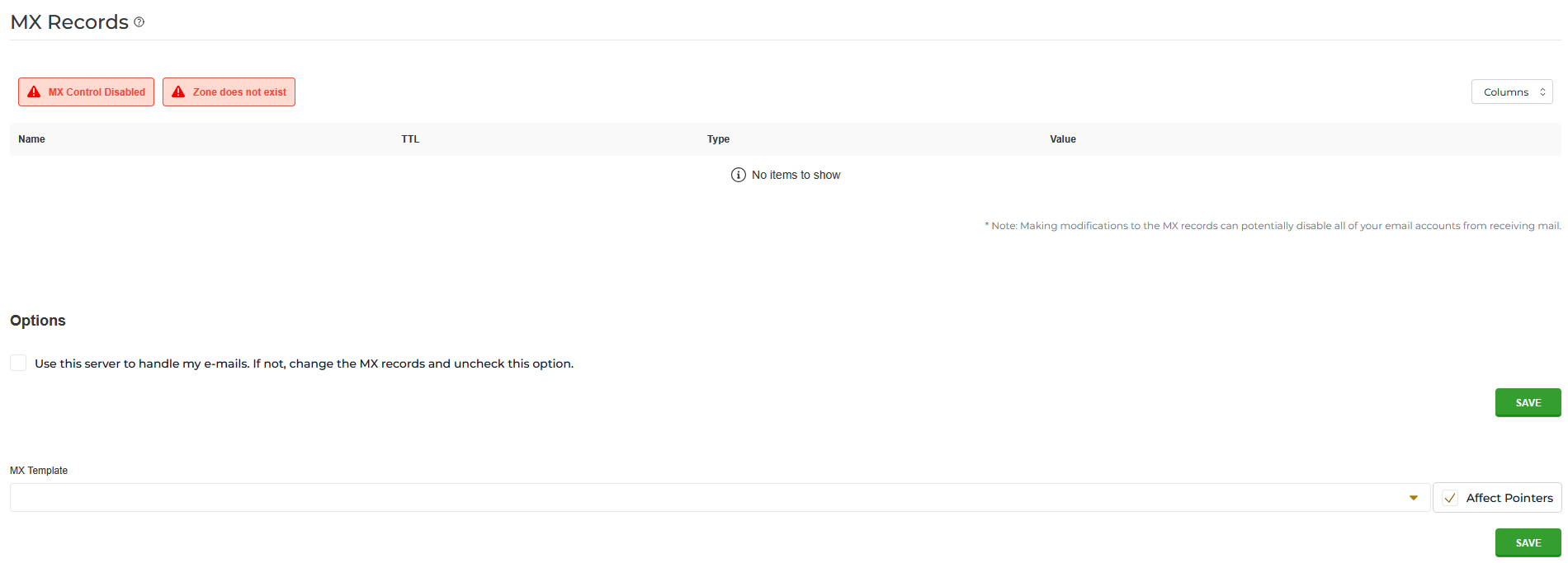

try to uncheck "Use this server to handle my emails" in user level MX record
i think that if is enabled, DA assumes the domain is fully local and forces the backup script to look for the /var/named/example.com.db file.
I checked and it looks like below. There aren't exist file in path/var/named/
