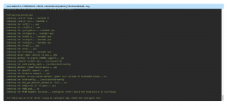

I have the same problem.
V 1.656 removed old php 5.x support completely.
I have encountered the Exim error during upgrade and I followed this advice, https://forum.directadmin.com/threads/exim-fails-to-build.69472/
After removing 'libiconv' , many services went down, including PHP x.x
When sending command, 'da build all', services gradually started up, except PHP 5.6 and PHP 7.2 .
Things begin to go crazy with this v.1.656 when I found that this NOTE on https://docs.directadmin.com/changelog/version-1.656.html :
Note:
Library libiconv is a special exception. There is no system library for libiconv because all its functionality is embedded in the modern libc library. This means that any library or binary linked against libiconv needs to be rebuilt to remove the no longer necessary link against external library and start relying on the built-in functionality.
After local version of libiconv is removed from /usr/local all CustomBuild managed software needs to be rebuilt using command da build all.
Now randomly trying to re-install PHP 5.6 but failed to work with all advices on the web. I have to halt all updates of DirectAdmin from now until the problem has been solved. I am waiting for a solution from somebody who might be able to help too.

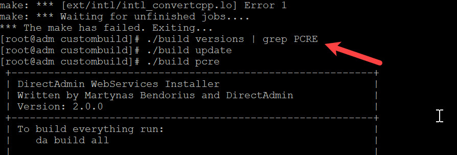

Can you try to install pcre-devel then compile again? I just removed old libs, reinstalled and php 5.6 is still working with DA 1.656
Can you guide me through the pcre-devel installation command? I used the command ./build pcre and it didn't produce any results.
