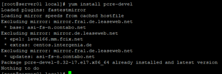

Trying to install PCRE again says it's already installed:

I found where this was and created a sym link to it, now the build goes further but errors:error: Please reinstall the iconv library
so try reinstall this lib from OS packages, or restore from old removals
