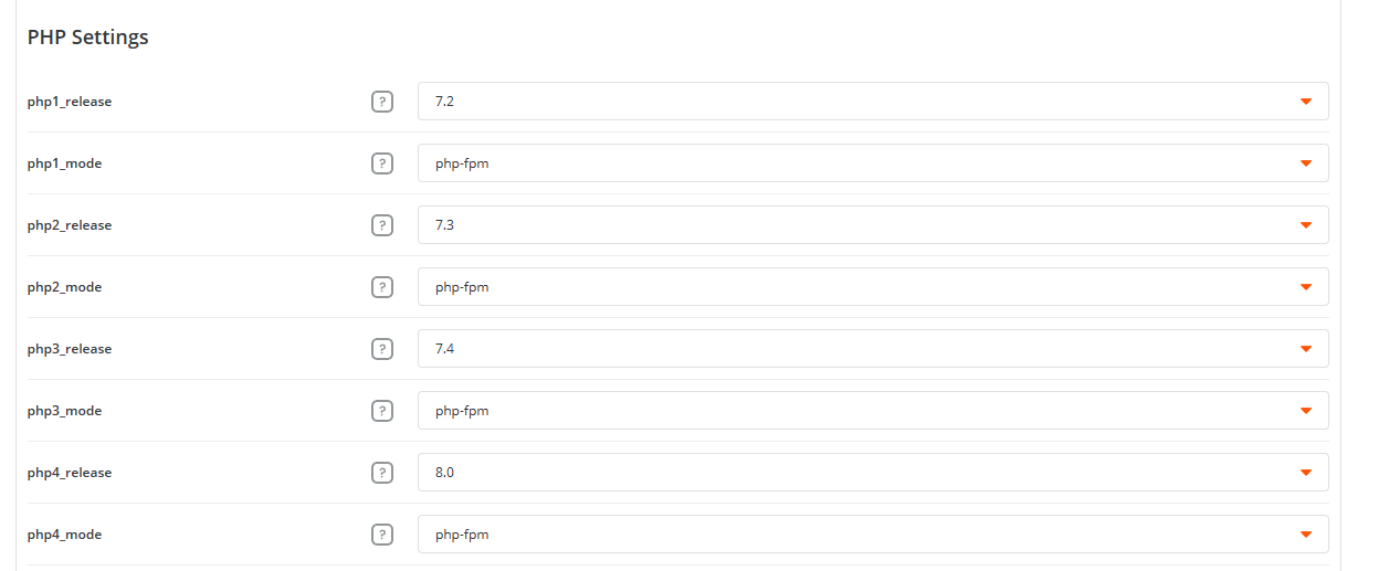

Just updated to CustomBuild 1.0.37 from 1.0.36 and it seems that by doing this, I am unable to change any of the CustomBuild "Edit Options" within the DA web interface.
Changing any value, including setting things like php2_release to "no" from 8.0 or any other value will cause the following error message to be displayed, and all updates are reversed.
Any idea what is causing this? Is it a known issue? This happens on a fresh install of DA as well as servers which have been running it for a long time.
Thanks!
