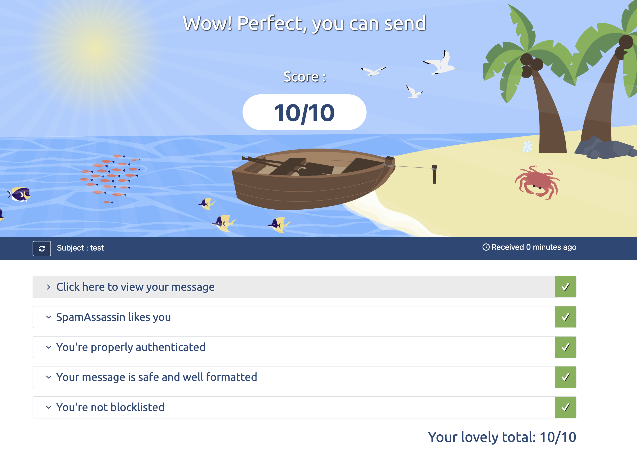

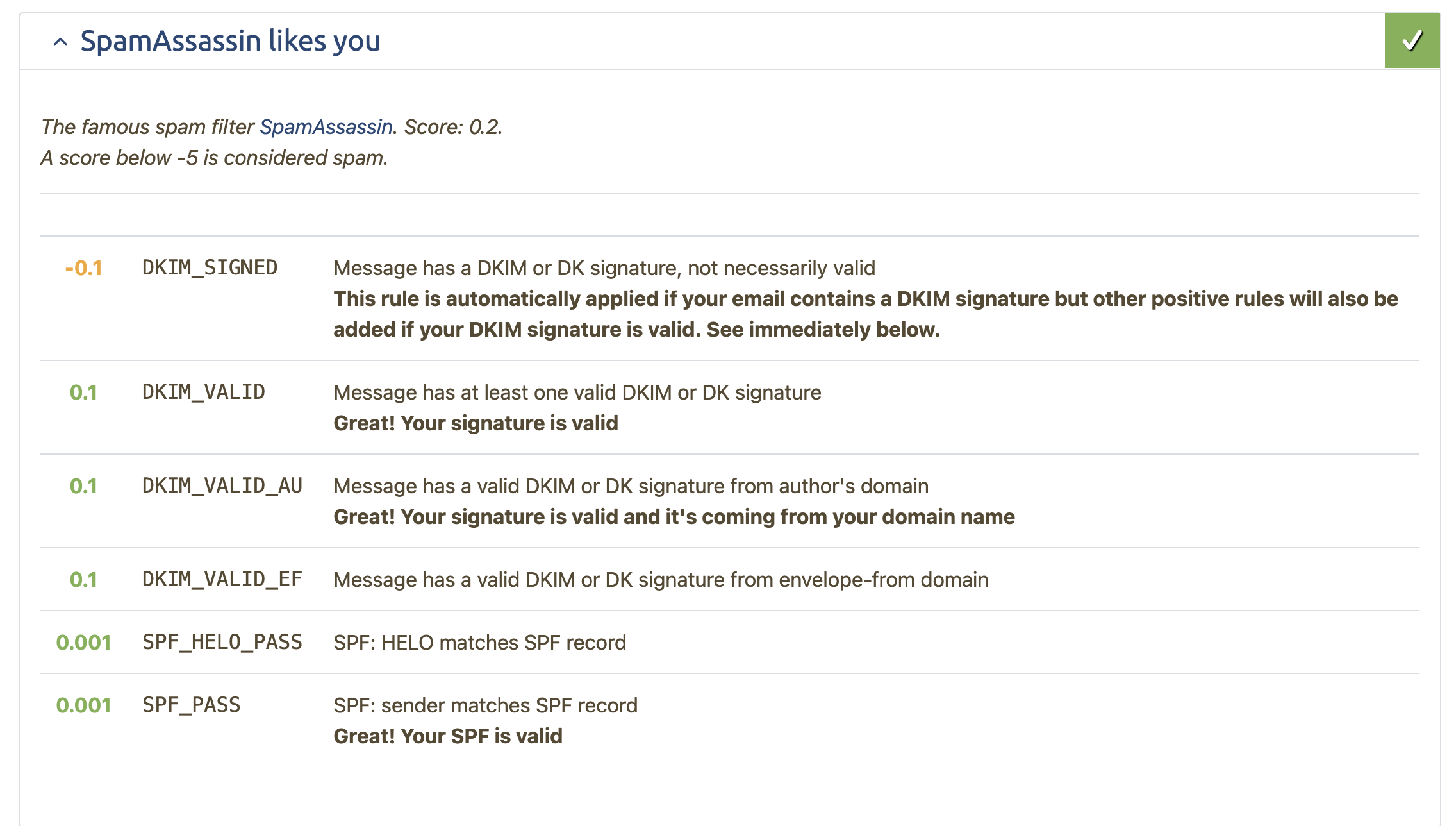

Hi Richard,
Thanksfor your support I appreciate it,
Everythings is back and better..
Here is the result we were waiting for yesterday :
Appreciate your help :D
Thanks again
