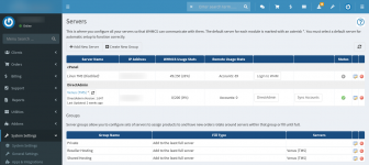

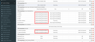

Have you updated the server to DirectAdmin option in servers and have the correct details?
Have you also changed the product to DirectAdmin?
@Jayjayuk Yep, please see attached images

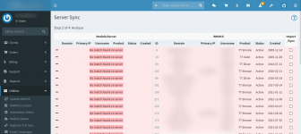

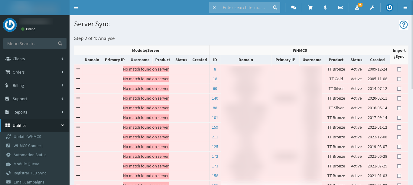

Ok, so if I go into each individual account and re-save the account under products and services it starts to show under the server now. But when i click sync it comes up with the following -
No match found on server

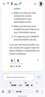

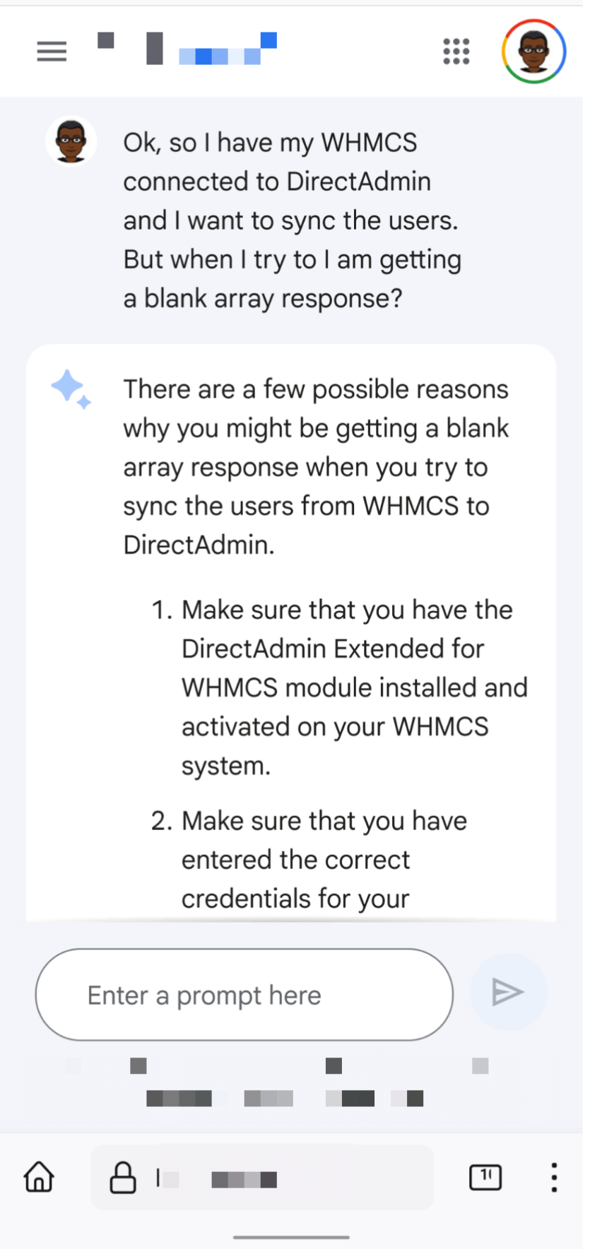

So, I asked an AI about the issue and this was the response. Please tell me this is not true?
I don't believe that's true. We use DirectAdmin with WHMCS and it works perfectly fine. I do have the same issue with usage statistics not showing correctly, but I suspect that's more of a WHMCS issue than DirectAdmin. Bear in mind that a lot of AI agents are based on datasets from some time ago, so the data/output may not be relevant any longer.
I remember that I had it too with a server. Because I had only a few accounts on that server, I removed the accounts and did a reinstall of the OS and DirectAdmin. After that it works without the need of any customization. So, the user accounts are showing, sync is working correct etc.
