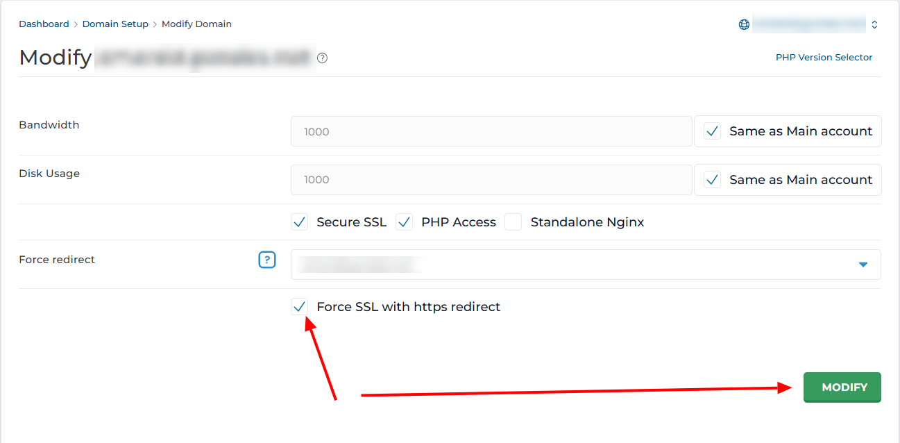

As far as I know DirectAdmin under Account Manager > Site Redirection can redirect only http://example.com/anything to http://another-example.com/anything
For redirecting HTTP -> HTTPS you should choose "Force SSL with https redirect" on a domain management page

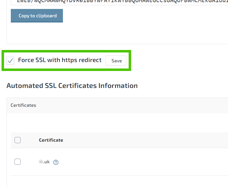

If you have an SSL certificate for the domain, you can also use the option in the SSL page to force a HTTPS redirect. I believe you'll get errors if you have a force redirect on and no certificate installed.
Pic taken from my production server and I use this as some of my software refuses to operate properly without HTTPS.
