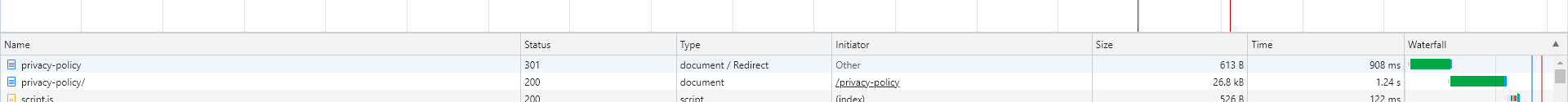

I was recently able to rent the above server, but still, the TTFB is high, and now I want to find out what is causing this.
For example
Reduce initial server response time
1.13 s
Keep the server response time for the main document short because all other requests depend on it. Learn more. FCPLCP
Themes, plugins, and server specifications all contribute to server response time. Consider finding a more optimized theme, carefully selecting an optimization plugin, and/or upgrading your server.
Learn more says:
WordPress #
Are their any server side settings that I need to consider to check out, that could help with the TTFB?
GTmatrix says:
Root document took 1.2s
Thank you in advance.
