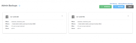

When creating backup programs, from admin, the saved schedule message does not appear and the scheduled time is not executed, but if a backup schedule is manually executed, it does work. In the directadmin error log we see the following message:
2023:06:25-02:58:07: generateCrontab: Bad file descriptor

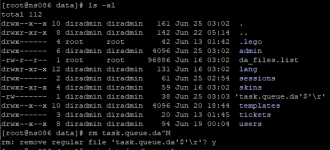

does not run correctly either and we can see that the file it creates in "/usr/local/directadmin/data/task.queue.da" does so with an incorrect format:
As expected, when Directadmin touches something, it stops working. As soon as I saw that in 1.650 there were changes in the management of scheduled backups, was there a 99% chance that the problem was the fault of that improvement? ? We have changed the update channel of the current line to the stable one (1.649) and after downgrading and restarting Directadmin, the scheduled backups have started working again and the mentioned error no longer appears.

hi @Yoshua, I think this problem affects only your server. Backups triggered by crontab stores these tasks into dataskq task file. Default location of this file is /usr/local/directadmin/data/task.queue.da. It is configurable in directadmin.conf file. Based on the file name you have reported it seems you are not using default file location but have customized malformed entry which has extra carriage-return symbol at the end of it (\r).
Starting DA 1.650 performs strict file name escaping. This means it will accurately use the file name configured in directadmin.conf even if it contains spaces or other white-space symbols.
If this hypothesis is correct I would recommend removing the customized taskqueueda=/usr/local/directadmin/data/task.queue.da line from directadmin.conf. My guess would be that whole file was modified on windows systems and got stray carriage-return symbols appended to all the values which could lead to other things not working as expected.
TL;DR - it is caused by malformed directadmin.conf file, and it has nothing to do with AlmaLinux 9.
If the file with surplus \r symbol is created not by DA but by your manual attempt of creating a crontab file then issue is somewhere else. Feel free to open a support ticket, this would give us a chance to get access to a server and verify it.
