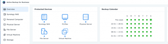

I'm maybe going a bit offtopic here but I switched to the Synology Active Backup for Business (free) package. It has an easy GUI and uses rsync to download the backups to your NAS. There is an activity log and you get notified if there are any errors. No need to use any scripts or open ports.
Maybe worth a try.
Except for port 22 I presume, which is normally used for rsync? Or what is that package using?
If it's software which uses fetch to rsync, so make outgoing connections, then at least the port on the DA server needs to be open, so you need an open port somewhere, right?
But rsync works nicely. I used it to sync between two of my qnap servers at home. Might indeed be worth a try.
I wasn’t entirely clear with that sentence, indeed that port (or whatever port you’re using) needs to be open on your server. I meant that on your home NAS / server you don’t need to open any ports or ranges.
