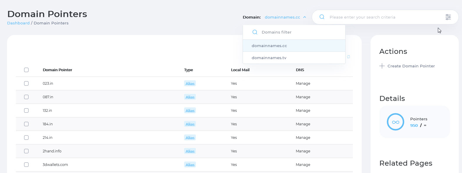

I have around 1200 domains.
80 of them are added as top level, and the remaining added as Alias (DomainPointer).

I have two parent domains for the user account named "kam",
The parent domain (end with .cc) have 950 Alias domains point to it and it's using self signed certificate.
While another parent domain (end with .tv) is using Let's encrypt certificate.

If you want to dig further, you can replicate the problem by create two parent domains, let's say domain1.com and domain2.com
Set the domain1.com use Self signed certificate
Set the domain2.com use Let's encrypt certificate
Then create domain3.com to domain999.com As Alias domains and point them to domain1.com.
I think it will be the best way to investigate into this problem.
