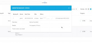

i am using this directadmin server from the last few years and backups are working fine. but from the last month onwards, the backup is not working and its showing the error or warning like backup stalled. I disabled csf and checked. still its have issues.

got the error PID not running
Its not a new server. its running fine from the last few years. But this error shows only after the update of directadmn
