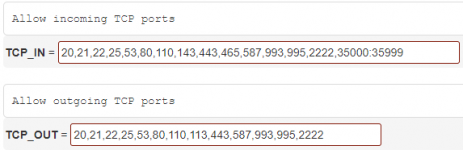

I see only port 465 smtp open but, could be while firewall is closed wen testing because of testing only
posrt in csf
Check that you have those ports open in the firewall on both your client OS as well as the server. A firewall could be blocking it on either side.
They are open:
posrt in csf
