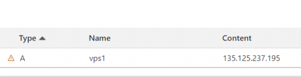

first config dns record at cloudflare like "serv.hostname.com" point to your server IPAddress with grey-clouded
login to your server terminal with "root" access,

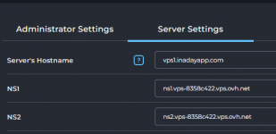

execute:
hostnamectl set-hostname serv.hostname.com
then login to directadmin panel:
Admin > Server Management > Admin settings

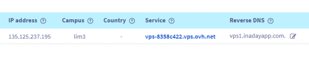

What does it matter? ovh-vps135-195 / vps1 / srv1 ? I changed it to vps1 for your sake.what is your hostname exactly ? ovh-vps135-195 ?
Why not using something easy like srv1 or so ? you have add only A record for your hostname linke this
srv1 3600 A 135.125.237.195, be sure that your hostname is correct in DA
Did you done this ?
If you are using external DNS than it doesn't really matter.What should be ns1 and ns2 on Directadmin?
