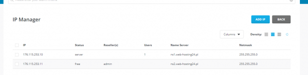

IP Manager

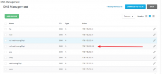

However, I do not know why intodns.com shows ns2 -> 176.115.253.102
Oke as said. Remove those 2 entry's in /etc/named.conf they should not be there!!
The problem is in your A record. For ns2 you have ip 176.115.253.102 instead of 176.115.253.11 so you made a typo there.

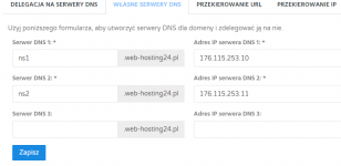

The domain at my domain registrar is explicitly configured to my two IP addresses

Yes, but not in directadmin. You have used .102 on the second NS in Directadmin instead of .11 so that is why you have that issue.

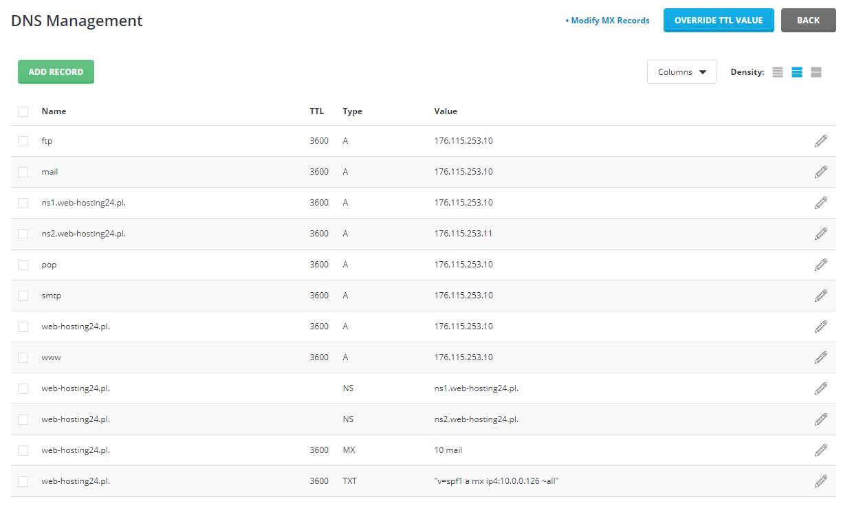

Wait, I make a screenshot for you, look at the arrow.

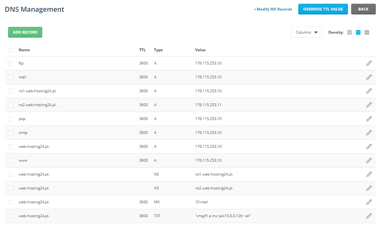

Sorry, the one below is up to date. The previous one was from 26-10-2020. Could DNS not be updated yet?
In this case I think something went wrong with the registrar, your nameservers are set up according to your screenshot, but it looks like they are not pushed by the registrar. Because otherwise at least the nameservers should already be pingable or should be able to be found via nslookup, which is not the case.
