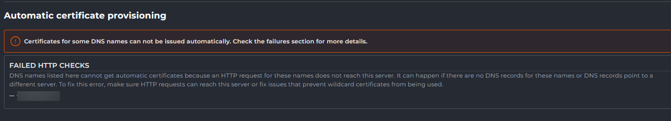

On 2 of my servers I am unable to generate certificates using the HTTP-01 challenge. On SSL/TLS Certificate page I get this error:
The wildcard option is disabled. It will not generate whatever I do. It does work with the test2.mydomain.com on a different server of mine. The systems are identical. The DNS setup is identical. The website are reachable, pingable. Everything is in working order.

Failed HTTP checks
DNS names listed here cannot get automatic certificates because an HTTP request for these names does not reach this server. It can happen if there are no DNS records for these names or DNS records point to a different server. To fix this error, make sure HTTP requests can reach this server or fix issues that prevent wildcard certificates from being used.
- test.mydomain.com
