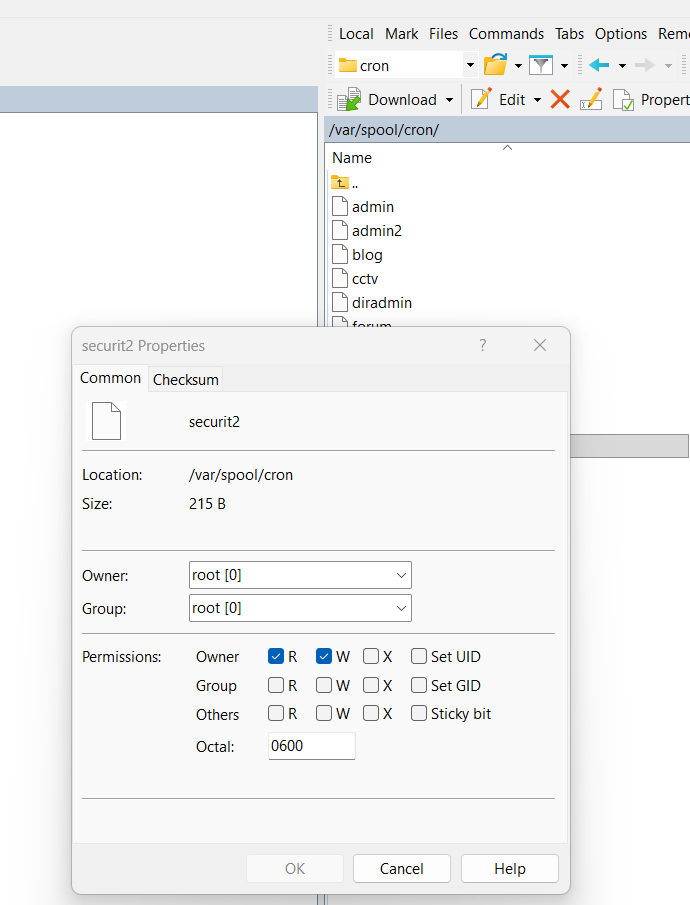

Crons not working
On Debian mine have differnt permissions, cron directory is owned br root and permissions 755
Inside cron directory is:

And inside crontabs directory everything is 600 with owner of the user and group is crontab
this is from working clone of non working server, both has the same
