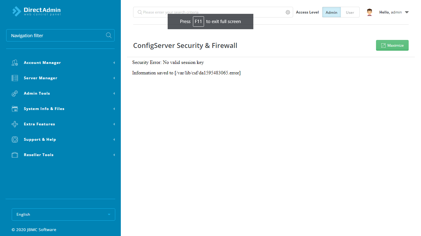

CSF dashboard not showing within Directadmin control panel
That is similar solution posted on #6. Reset all directadmin permission files.
The reset of all directadmin permissions with set_permissions.sh all was not the solution.
It works well with : chmod 711 /usr/local/directadmin/plugins
This solved the problem.
My bad because I thought the script would also change the folder since that folder belongs to DA. I gone through the code and I also did not see any plugins path that is set in the set_permission.sh.
My issue above was a bug, support informed me of the solution and it worked fine.
Permissions on /usr/local/directadmin/plugins need to be set to 711.
Tried that and now when trying to login to the Directadmin dashboard its saying:
ERROR
Cannot read property '0' of undefined
Tried in a different browser, different error:
Error
t.DOMAIN_LIST is undefined
UPDATE: Had to change back to 755 for it to work again. (CSF still not working within the DA dashboard)
