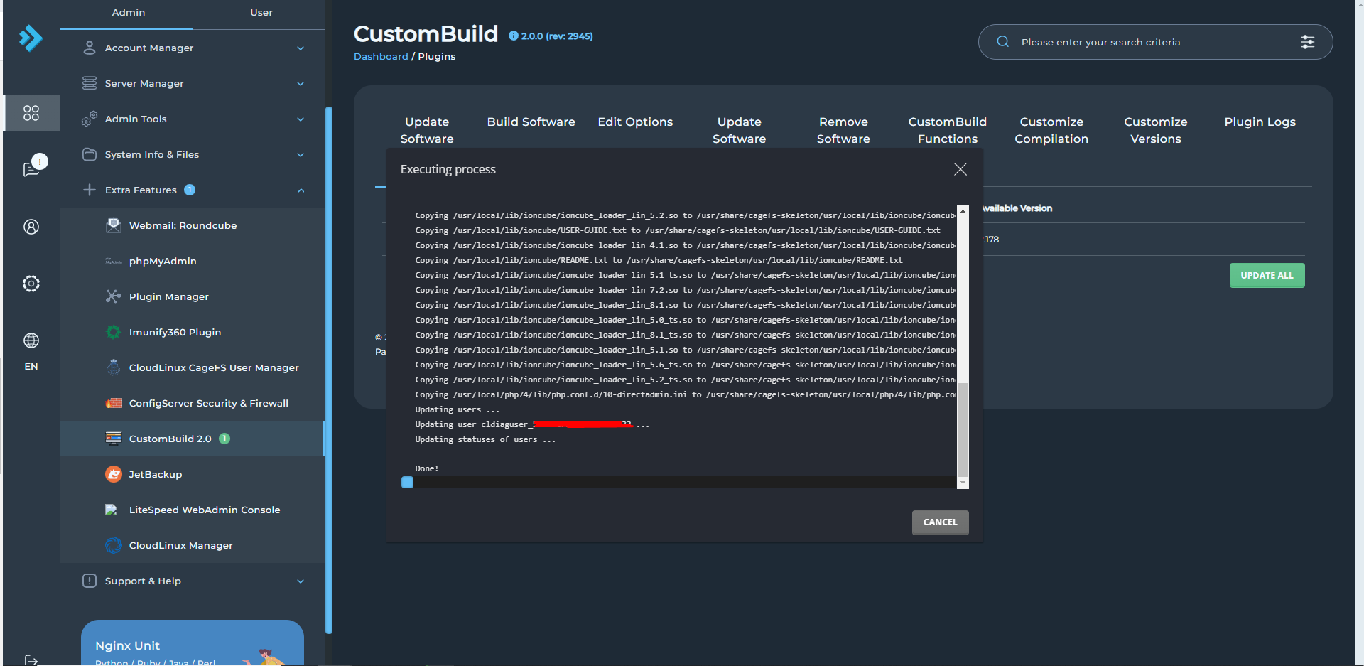

So, when I go into Custom Build 2.0 I can see there are things to install on the Build Software tab, lets say here for example I have installed IonCube or ImapSync. The install progress never finishes so I dont know if its hanging?

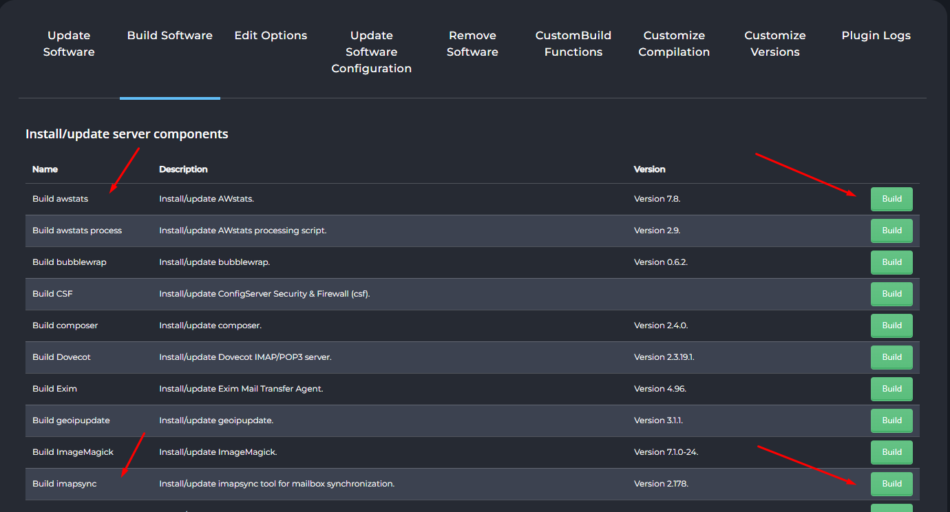

Another frustration I have is how can I see a list of the installed softwares? Because I click build, even though some other softwares should be installed already. For example inside the same "Build Software" tab. I can see here that there are things like AWStats and Imapsync saying "Build" even though I already did earlier?

It has been finish already ?, this bug has been stay in cb long time , a button cancel must be done txt ofter complete installation, but show cancel button .

Oh I see, thank you! Is there a way to see "installed/built software" so I can see what I arlready have?

Yes i think so , it must show 2 button there if any previous build has been done before
1 button for version has been installed and other button force build ( red and green button maybe ? )
So it not make any confusing right
It says "Done" at the bottom, right? So that means it's finished.

It seems they just stay as "build" for me and doesnt get updated to new buttons. Very weird.

Yes, but I was expecting the status bar to fill up and cancel to change to finish or something.

that "Build Software" tab alway be like this, it just for build or re-build script.
You should checking in "Update Software" tab, if it fail, list the software that doesn't finish or need updated will show here.
