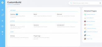

Custombuild plugin is now deprecated. You will need to remove the plugin, switch to Evolution skin and use a native Custombuild interface. You can find it in the screenshot.
