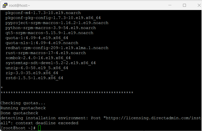

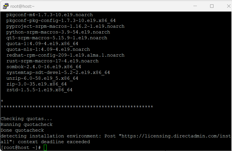

For several days I was experienced problems with a DA server that was previously working. Looked like DNS problem first, then, I changed to another IP asnd tried to reinstall a clean copy. It does not install. I see this message:
* Installing pre-install packages ....
Checking quotas...
Running quotacheck
Done quotacheck
detecting installation environment: Post "https://licensing.directadmin.com/install": context deadline exceeded
[root@server-5-2-136-71 ~]#

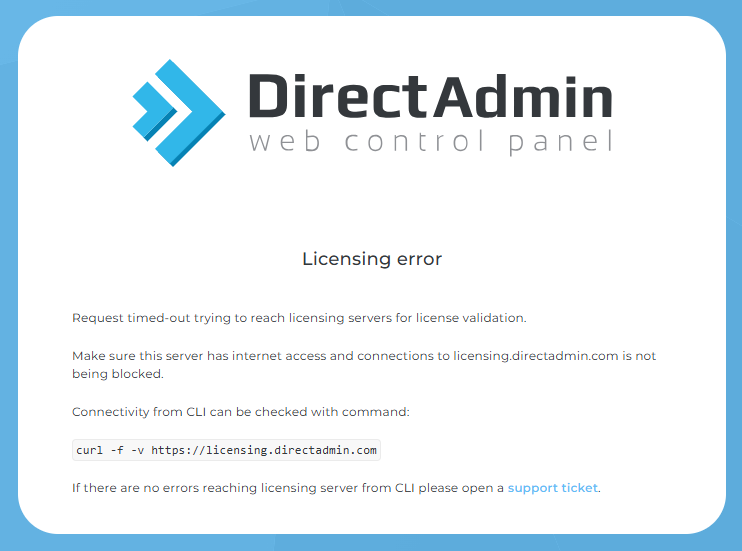

Yes thank you for the reply but still not working. Managed to finish install but I get error message for a valid license. I ran that curl....and nothing, same license error. I sent you detailes in the ticket.
