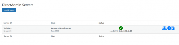

We have made some updates to the design for statistics, If already installed you can update the plugn within WordPress plugin manager automatic updates.

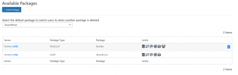

I have almost finished the Packages Manager feature today.
You can:
  • Add/Remove user/reseller packages
  • Set the default package so if a package is removed it will switch all users on that package to the default.
  • Protect the default package from being deleted. (can be deleted manually in DA itself)
If a package is deleted manually in DA server itself when a user is loaded in WordPress plugin and it cant find the package the plugin will switch users to the default package, you can stop user switching in the user settings if you wish.

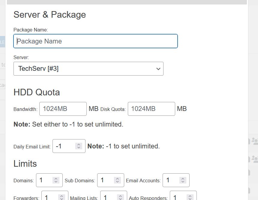

I am about to push a version update to add the new "add user package" function. This now allows you to add and remove user/reseller hosting packages. Version 1.2.0.0

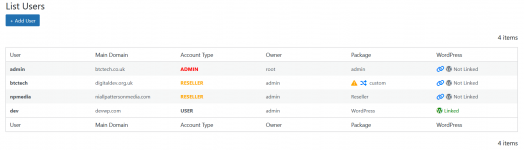

Linking existing user accounts to your internal WordPress Accounts, once a DA account is linked to a WP we can have short codes for users on the front end like [controlpanel] or [domain id="someusersdomain.com"] so the user has access to domain functions on your wordpress front end.
This user panel also has a feature to switch a user to a default package if a "custom" package is detected, again if a package is removed the plugin will switch any users on that package to the "default" package.
Once a user is linked we can sync password between accounts, if a user changes email address we can sync this information as well.
I will make PRO features to link multiple accounts together etc in the future once up and running.dd_user_panel.png

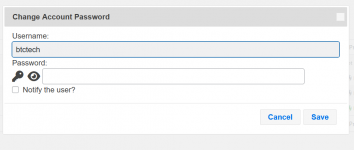

New version 1.2.2.0 pushed to update server with some prerequisits for future features such as added in some new database tables to record daily server statistics, we have added in CRON automation so we can perform automated checks and tasks through the wordpress cron class. I have also tidied up error messages and the admin user experience a little however i notice on mobile the popups for adding servers/users etc arent too clever yet.
Been a busy night programming last night was up until 4AM!!!! Here are some new features in 1.2.2.2 i managed to get done.
= 1.2.2.2 =
Added new change password and suspend account features
Added in provisions for PRO features (extra features for pro members)
Added in SMS textlocal API
Now shows user email under info icon in user lists.
Added function to reboot server
Added a restart service feature and check_service function
If requested the plugin will notify user via email when there password is changed.change_passwd.png

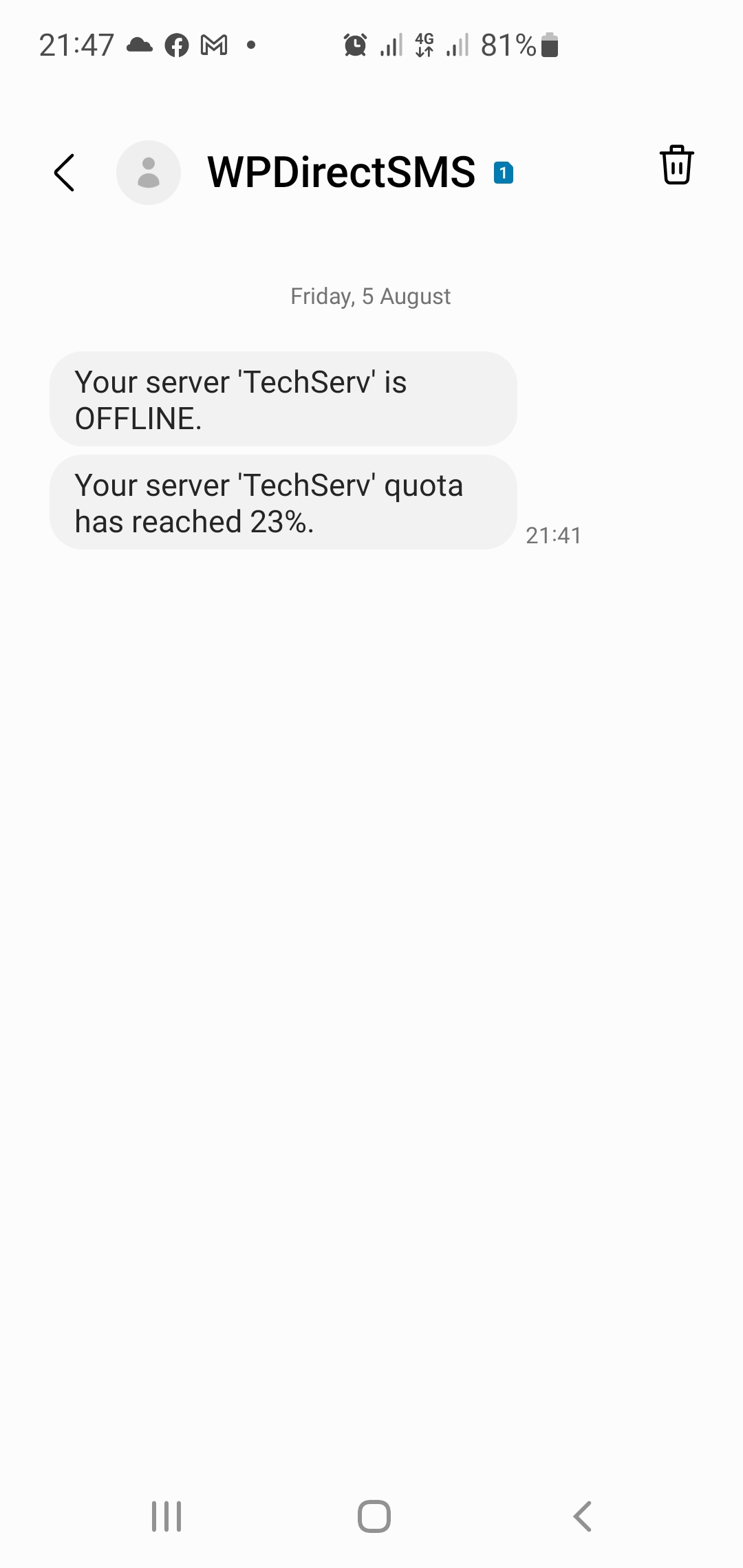

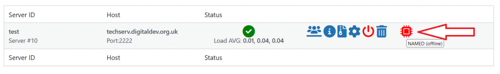

Since my NAMED service wont boot up i thought id use this as the perfect chance to get in service down alarms into the plugin, you can set alarms to trigger on any or all services on the server, alarms can be sent via SMS, EMAIL and URL where URL will post $data['service'] and $data[server_id] and $data[status;] TRUE|FALSE
