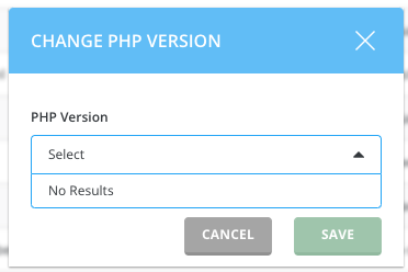

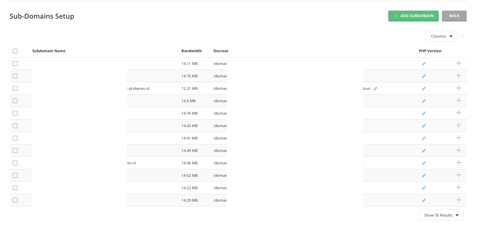

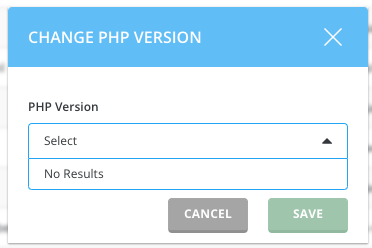

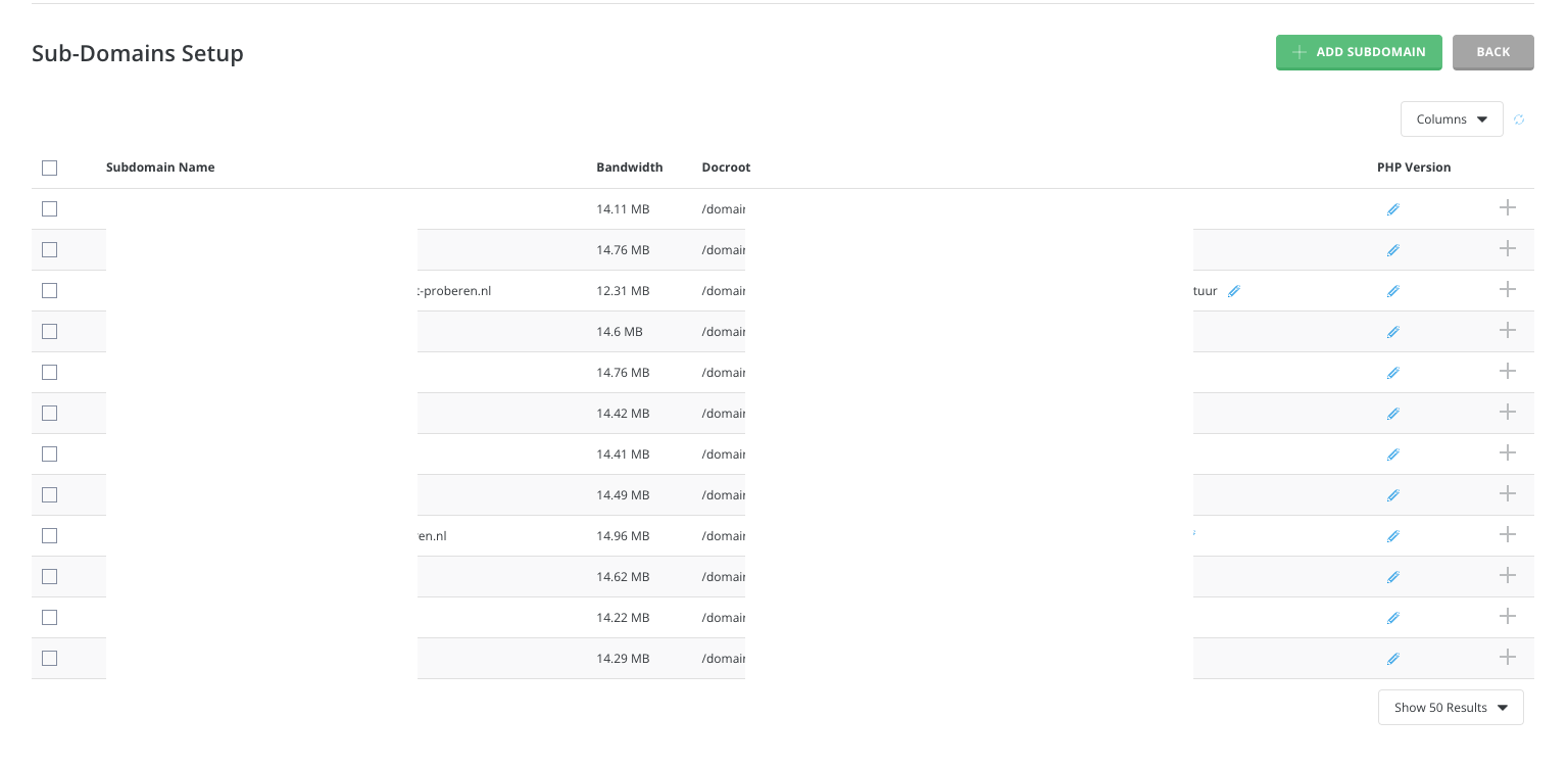

@Joriz a special control knob for PHP selector availability only on sub-domain level sounds like a very niche use-case. Does keeping the option to change PHP version for sub-domains causes any problems?
This is really unwanted behaviour as this offers a button and additional non working option to customers.
This causes frustration for less tech savvy customers as they don't understand that they need to be somewhere else at the normal "PHP Selector". Causing customers getting stuck wanting to change the PHP version for their hosting package.
Also more technical customers are really picky about this and would like to see a 'perfect' control panel.
So if the 'PHP version' row under Sub domains can be disabled/enabled that would be great.
Now there is no parameter what influences this. You would expect that php_version_selector or an other parameter would influence this behaviour.
