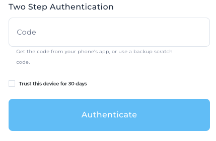

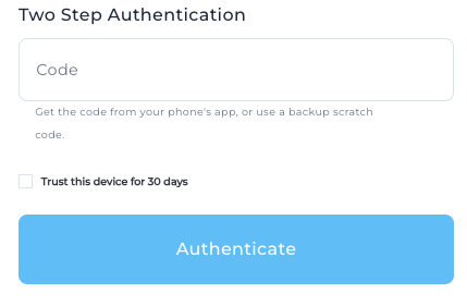

Bug:
"Trust this device for 30 days" does not work. Confirmed in Chrome and also in Safari on desktops. Doesn't do anything when clicked.
