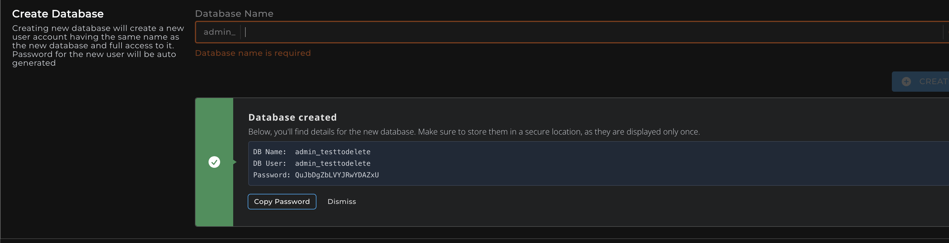

After creating a database you get the notification "Database name is required"

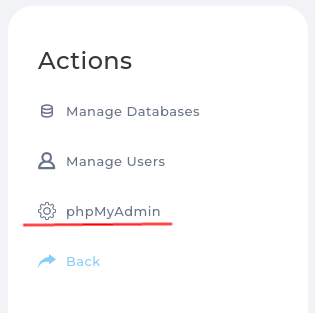

Why on /evo/user/database there's no longer option "Sign in phpmyadmin" ? and why it's again counting size of my databases if I turned it off months ago?
EDIT: Oh, I can see there's "phpmyadmin" when I go to some DATABASE but it's signin me only just to that one database lol if I have 5000 databases it's not comfortable for me... can you return that option to all databases at once?
:D

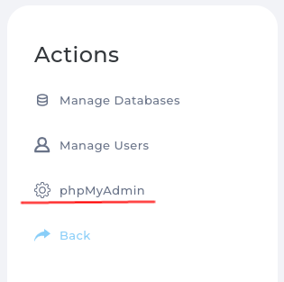

Link to PhpMyAdmin is available once you select a DB to manage. Not quite sure what you had in mind with turning off DB size counting. Showing the size of the database is not tied to any configuration options.

2. Before DA <1.659 I could signin to ALL DATABASES in phpmyadmin AT ONCE (at page with view to all databases), not clicking every database separately, it's waste of time!
Thanks for clarification.
Database size is now retrieved much more efficiently than before, so there is no real performance benefit in not counting it. Option show-db-usage will be eligible for removal in future releases.
Global PhpMyAdmin access is available from the main menu (Extra Features section). It will give you access to all databases. So we decided there is need to duplicate it inside the DB list page.
thanks for the explanation, it all makes sense now :P I didn't notice that phpmyadmin works that way there :)
