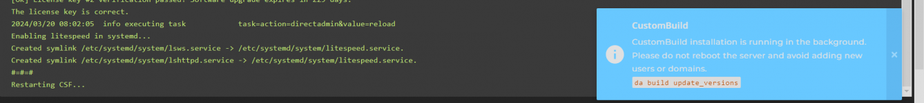

directadmin update, has been running for like 10 hours already, and still going.
and no, no manual restart of CSF.

@Zhenmue the screenshot shows CustomBuild updating 3rd party system components it is not the same as DirectAdmin update. I would recommend checking the process list to see where CustomBuild script is stuck. If you still have problems with if please open a support ticket. This seems to be a local problem.
