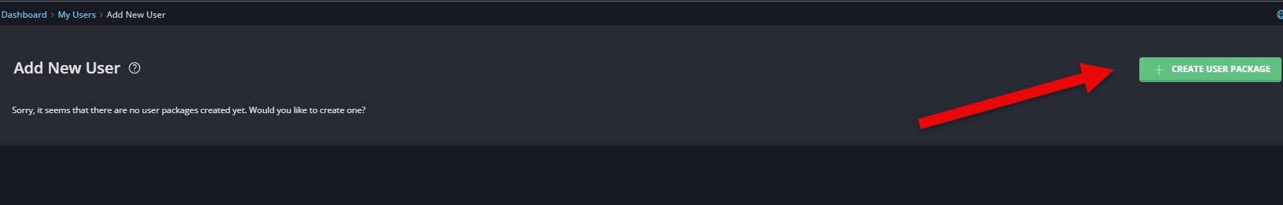

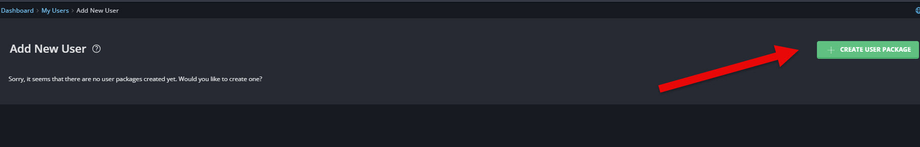

The button add user packages if none have been created yet does not work. you can click whatever you want nothing happens.
  • Like
Reactions: fln
Just tested it under new Reseller and can confirm the same situation on DA 1.672.
Downgraded to version 1.671 - it works fine.
I will open internal report to developers to check it closer.

Thanks @exlhost. An update is released with the following fixes:
  • Fixed the button to create a new package.
  • Fixed the number of days to remember the 2FA secret on the login page.
