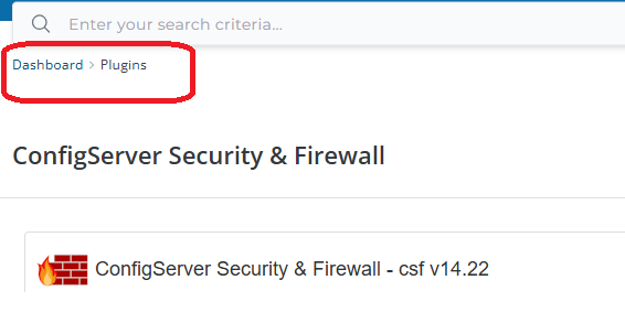

Hi;
after update to 1.673 all plugings missing header menu
in 1.672 menus working
in 1673 missing the head menus
