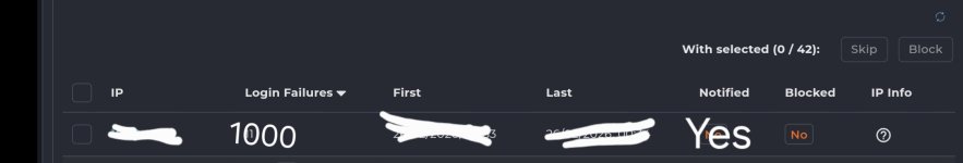

Since notify must be reset with "clear_brute_log_time", otherwise in won't trigger block anymore on the same IP until timing has pass "24hr"( default value ).
Then temp block should using "clear_brute_log_time" instead of "unblock_brute_ip_time".
Example: I just want to block for 2hr. If timing lower than "clear_brute_log_time", it become free bruteforce.
Look at the picture, when I blocked for 2hr and keep "clear_brute_log_time" to "24" hr.
In this picture, it only blocked on the first time, and then after unblock 2hr, it's free spam on that day.
Because "notified" column still flag as "Yes", meant no more notify to script until reset it.
It is true if you rely on CSF/LFD to unblock IP. In my solution, we leave it up to DirectAdmin to unblock an IP when time comes. We need to use TTL in CSF when we want to block an IP temporary, so in this case TTL might be any value greater than real value in DirectAdmin.
