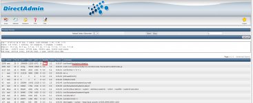

dataskq process has ~45% of CPU usage, causes Node.js process to lag.
[root@vps8600 /]# killall -USR1 dataskq
[root@vps8600 /]# tail -n 10 /var/log/directadmin/errortaskq.log

dataskq process has ~45% of CPU usage, causes Node.js process to lag. I tried to disable dataskq's crontab task but it breaks Let's Encrypt work, so I reverted that.
