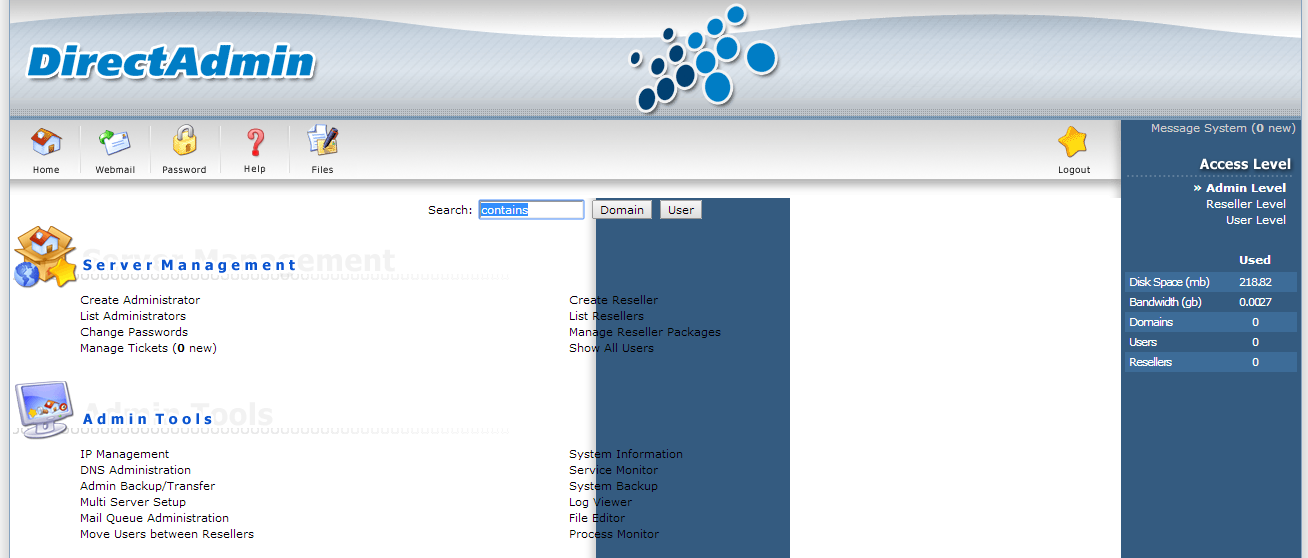

Look here, it is a clean install, but after 1 day is shows this.
php.ini had zend.multibyte after deleted line everything was ok.
Check the /usr/local/bin/php binary.. as that's what DA uses for output.
It if gives you any headers, that's the issue.. as it shouldn't have anything but the php output.
Sample valid output:
[root@server ~]# php<?php
echo "test\n";
test
[root@server ~]#
Sample invalid output:
<?php
echo "test\n";
X-php-header: something
test
[root@server ~]#
Use ctrl-d to end your input (press twice, if one has no effect).
