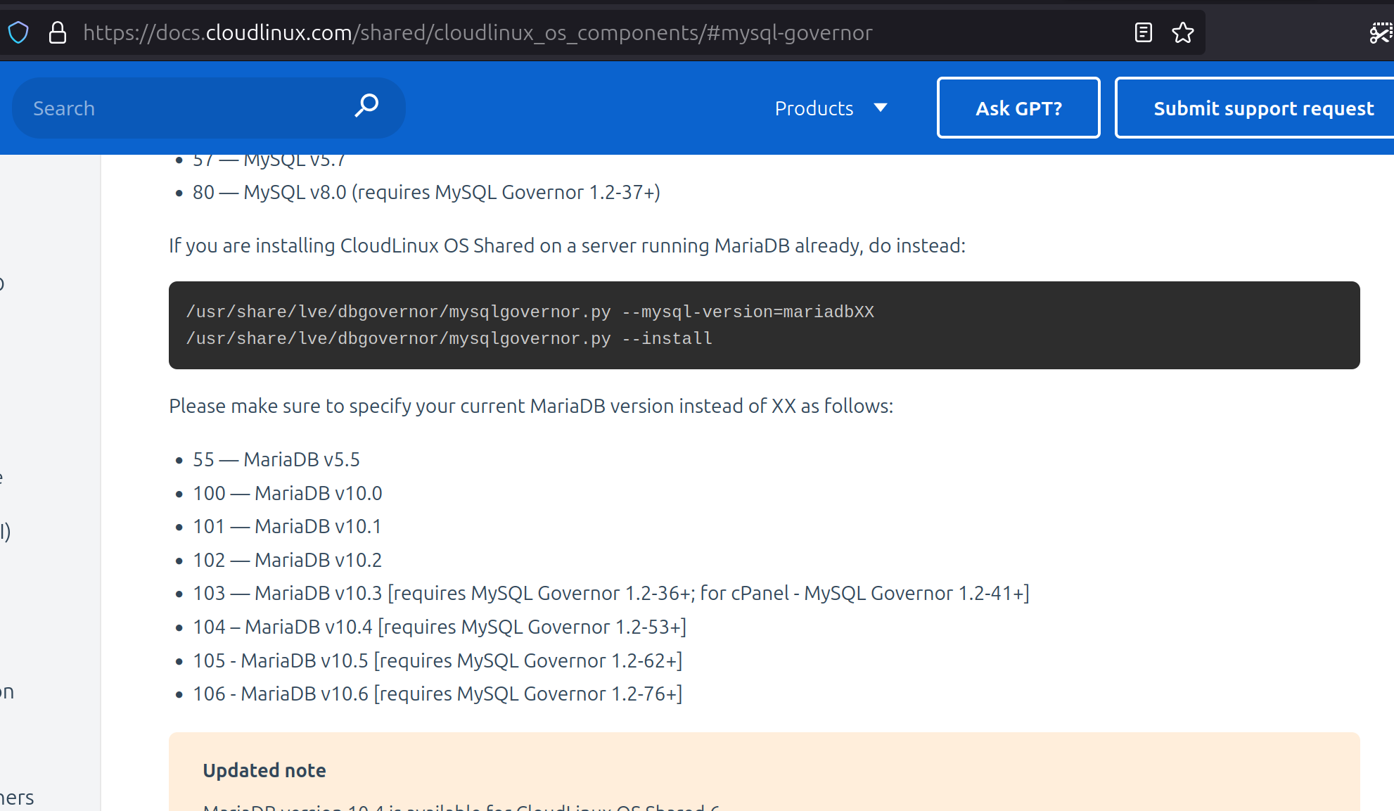

because they do not changed their docs - I do what every normal person shoudl do - read the docs and follow them - there it stops to 106 (still)
that's is just a docs, you should focus on change logs.
sometime docs might outdated. because software developer always focus on update their software without makechange the docs and between 10.6 and 11 doesn't change too much on Govenor version required.
