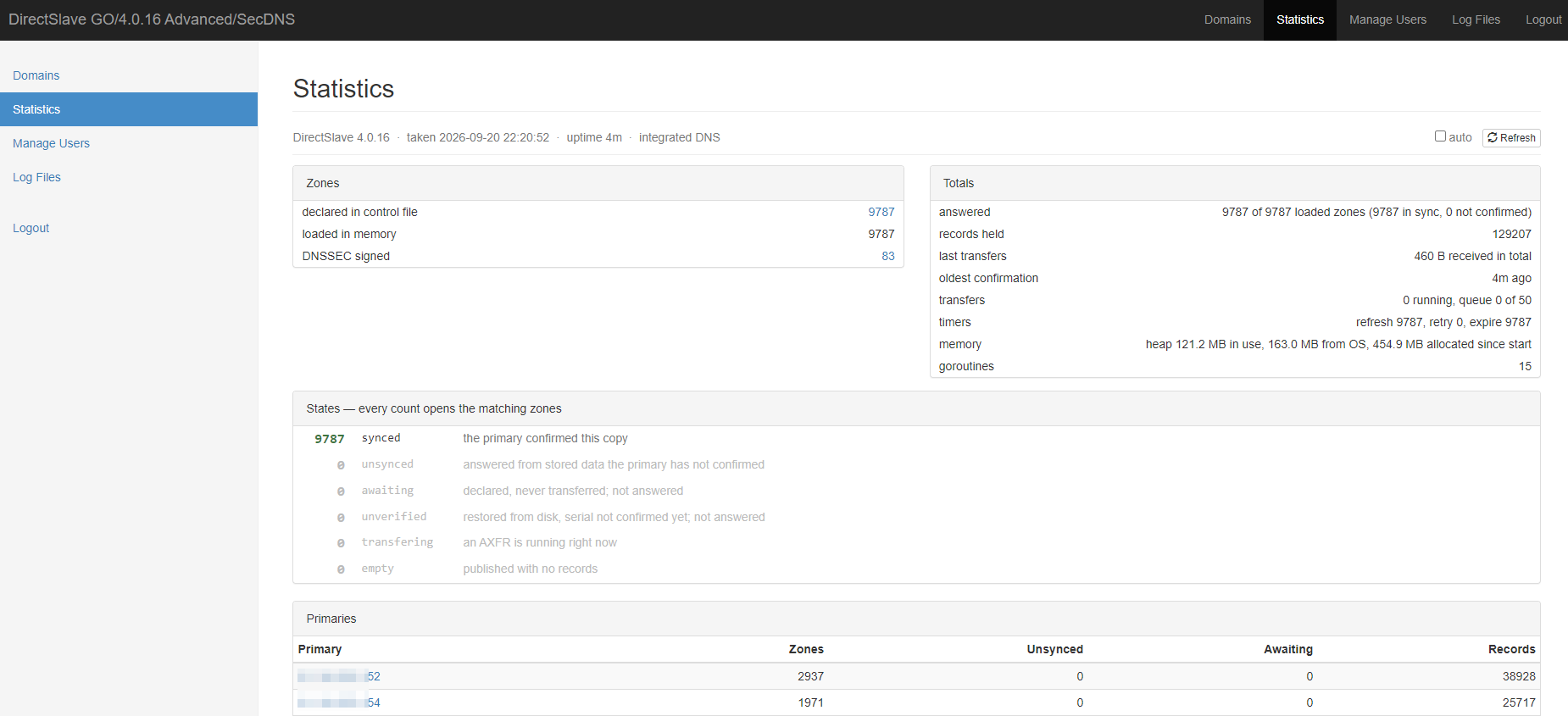

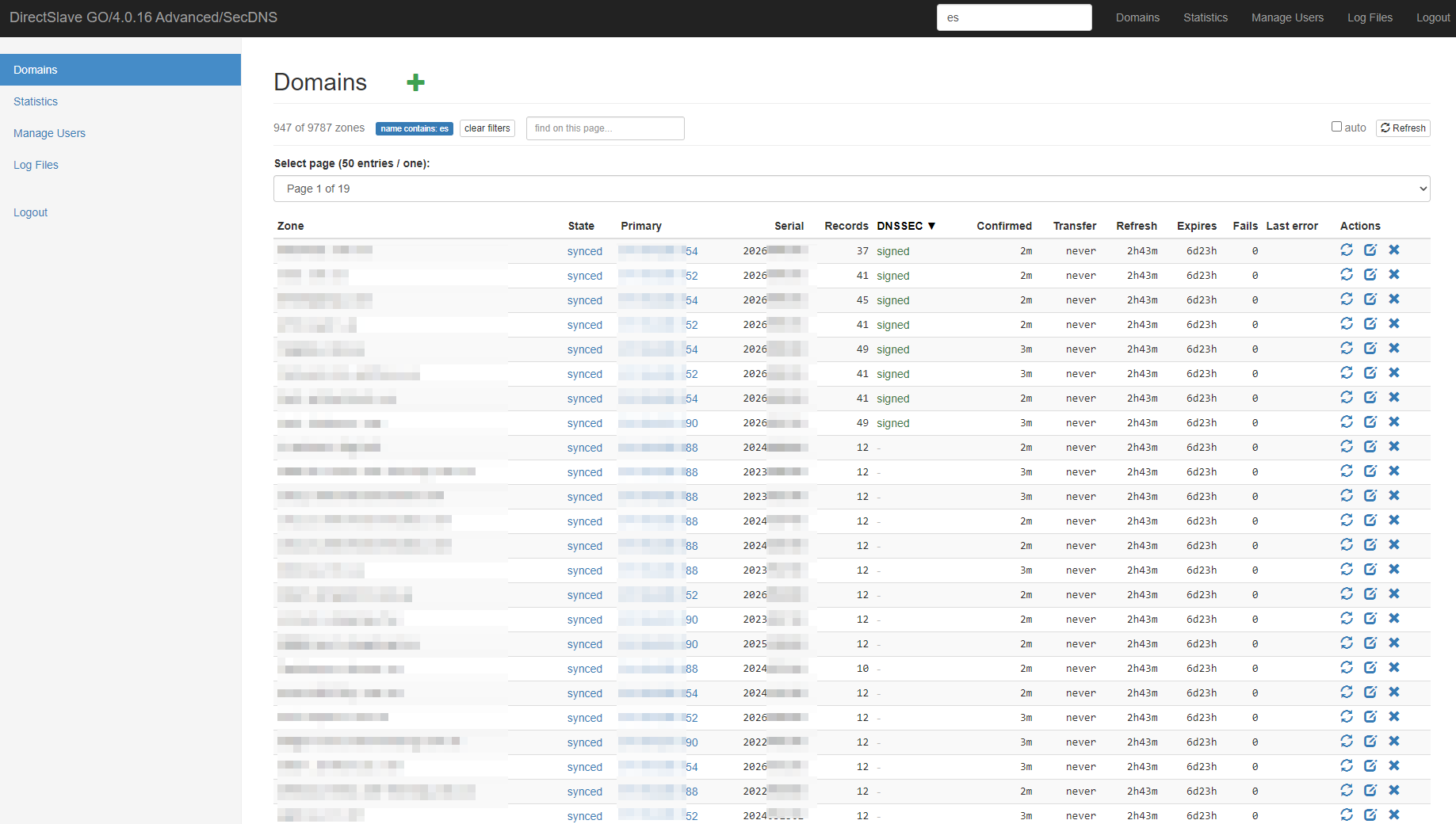

For new DirectSlave/GO 3 public beta see this thread -- https://forum.directadmin.com/showthread.php?t=54992
All versions in one place -- https://directslave.com/
Web interface demo available -- https://directslave.com:2224 demo:demo123
