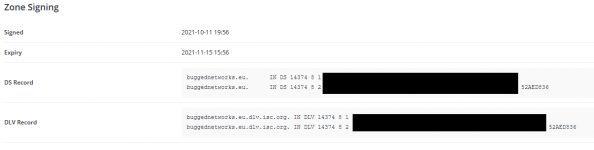

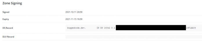

dnssec-ok.png => Screenshot from another server, all DS/DLV records present.
dnssec-problem.png => Only one DS record generated for some reason...

Okay, problem 2 is solved, looks like those records are no longer needed on modern systems, maybe that is why the signtool is no longer generating them. I signed a testdomain today and everything is working again (according to https://dnssec-analyzer.verisignlabs.com ).
