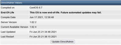

Do I need to update the OS?
100%.
You are using an OS that is at/near 2 years EOF since DirectAdmin stops supporting a OS after 2 years of EOF. (EOF = End of Life)
And I hate to say it but CentOS 7 is now also EOF (redhead retired it early because they took CentOS over) and CentOS 8 is now CentOS Stream (A BETA testing OS for redhead so not recommended for production.).
So if I was you I would look around to a new OS distro to use and learn. It may be frustrating now but it will be way better in the long run.
