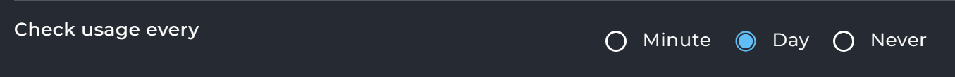

In Admin -> Server Manager -> Administrative settings -> Server settings
- I disabled 'check usage' (did not solve the problem)

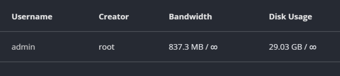

And at the moment this is the overview:
So possibly there is something with the unlimited (bandwidth) setting that does not work correct.
I'm gonna see what happens this night, so I can check tomorrow i it's again around the currently used bandwidth.

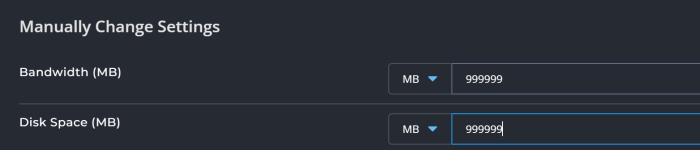

I now changed the bandwidth, I will check tomorrow if it helped.

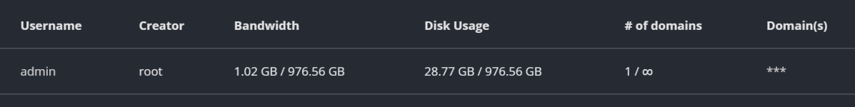

Just as a reference for myself, here the steps :-)
I modified the settings for the admin user. This means it overwrites the settings of the chosen package (which has everything set to unlimited).
This is shown in the domain overview:
