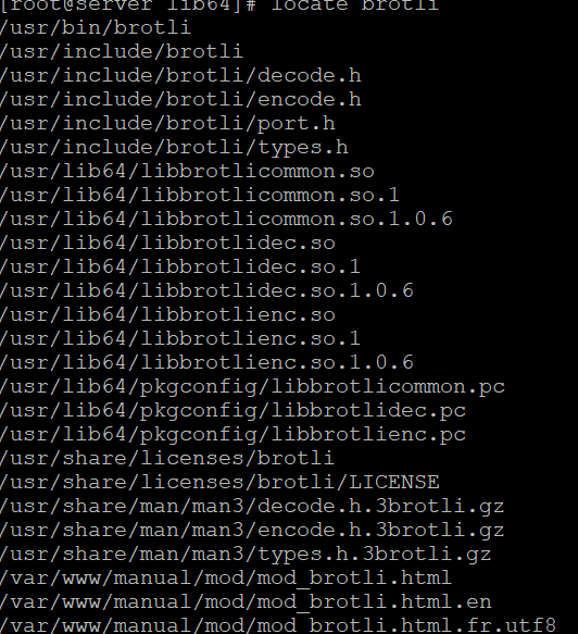

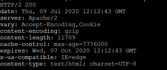

@D-Lew i gotta bump your post. Trying to get brotli running.
I did exactly your configuration but it's not working.
I'm trying to figure out what im missing here.
I figure i should add mod_brotli.so in httpd-includes.conf, but there is no mod_brotli.so
So noob question, should i install?:
git clone --depth=1 --recursive https://github.com/kjdev/apache-mod-brotli.git
cd apache-mod-brotli
./autogen.sh
./configure
make
This is what i got:
