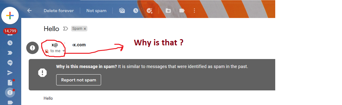

To look at Gmail just look on the right click on the ellipse for More > show original
do you see pass
SPF:PASS with IP
DKIM:'PASS' with domain
DMARC:'PASS'
