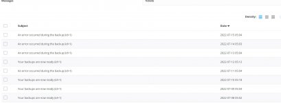

Today i have received another error :
An error occurred during the backup (id=1)​
2022-07-16 05:36
Error Compressing the backup file admin.root.admin.tar.zst : zstd: error 25 : Write error : No space left on device (cannot write compressed block)
/bin/tar: -: Wrote only 6144 of 10240 bytes
/bin/tar: Error is not recoverable: exiting now
