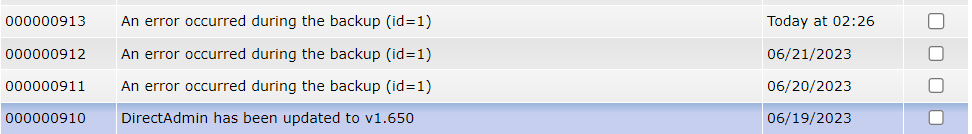

I did search, a lot, and found several threads that deal with Backup problems, but non that seem to be the same as the problem I'm having.
This server has been running perfectly for the past 2 years.
Nothing changed on the server recently that could account for this error (except if it is related to the DirectAdmin upgrade).
The error is the same each time:
User academy has been backed up. <2:22:48>
User cbtv has been backed up. <2:22:58>
Error Compressing the backup file /home/admin/admin_backups/colorbase/backup/home.tar.gz : /bin/tar: c\:\temp\\junk.txt:
Cannot stat: No such file or directory
/bin/tar: Exiting with failure status due to previous errors
<2:25:18>
User dev has been backed up. <2:26:55>
User live has been backed up. <2:26:55>
There is more than enough disk space available for the backup, so that's not the problem.
It's also not a problem of access rights, I checked that.
What seems odd, is this part of the error message: "c\:\temp\\junk.txt" <-- that looks like a Windows' path to me. Why would that show up on a Linux machine?
The server is running Centos 7 (Yep, I know v7 will be deprecated, this machine is to be decommisioned at the end of this year, but it still needs to last the coming 6 months).
I hope someone can help me with this ?

Update:
It turns out that a file with the name "c:\temp\junk.txt" does actually exist. But I stumbled upon that file just by accident, 'cause it didn't show up when I searched for it using find or grep.
Now, apart from the fact that that file should not be there, I do consider this a bug in the DirectAdmin backup software.
A backup should not fail, just because a file with that name exists, right?
