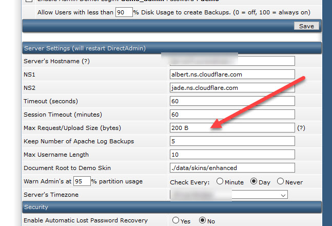

Hi again i fix this problem ,
i dont no ! why max Request /Upload Size why 200 B
DA Console did not have access to change size .
i set from ssh
/usr/local/directadmin/conf/directadmin.conf
Set size : 128M
The problem was solved .
Thank you very much
