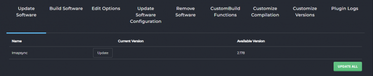

Everytime I try update ImapSync it stays here
Jordz2203
Sep 8, 2022
75
I also ran
/usr/local/directadmin/custombuild/build imapsync
And it didnt work
And it didnt work
Nobody can do anything with "Didn't work".
If you build via SSH you will get an out put and error message, post the error message.
If there is no error message, then it can be that everything works fine but Custombuild addon has an issue.

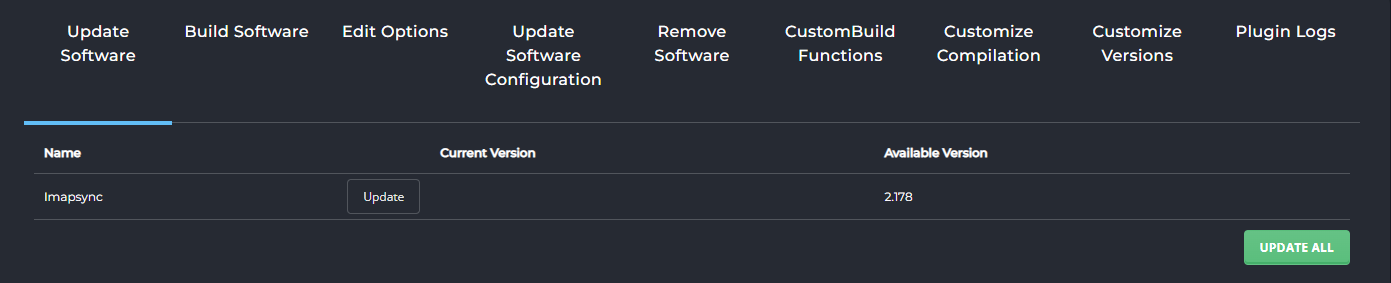

Sorry, my bad. This I was implying the issue was that CustomBuild is registering that imapSync needs an update. The update ran successfully but CustomBuild doesnt think so
Yep, that might be a custombuild addon issue then if everything is running fine.
In the new DA version, they are integrating the Custombuild plugin, maybe there something causes some odd issues. I'm not 100% sure but it wouldn't be the first time that there is a difference between the addon and everything is still working fine.
