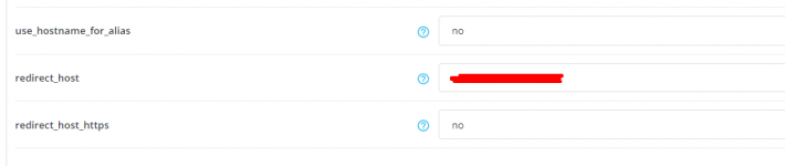

My server is configured that way only.
Only domain needs to have a valid SSL certificate and DA control panel can be accessed from
I attaching a Screenshot for your reference.
Note: As far as I know, use_hostname_for_alias should be 'yes' if you want everyone to be redirected on hostname.
I have set it to 'no' so that customer can login from their own domain if they have a Valid SSL ( )
Custom Build > Edit Options.
Find 'redirect_host_https' and change it to 'yes' from 'no' and your hostname will be redirected to https
