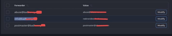

Hi, I created the mail forwarders in the panel. and even checked their existing ones in the file
cat /etc/virtual/badbuXXXX.XX/aliases
abuse:[email protected]
info:[email protected]
postmaster:[email protected]
*::fail:
But when try send email to forwarder...
<[email protected]>: host badbXXXXX.XXX[5.135.XX.XX] said: 550 No such recipient
    here (in reply to RCPT TO command)
Apreciate help.
