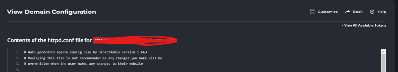

I am not sure how to do that. When I click on "customize" it doesn't give me the option to remove or revert, just add values to what already exists. 1718567348309.png
Here I only get the "customize" button. Is there another method to remove what I added? 1718567405891.png
Did you also checked the custom boxes for entry's? CUSTOM1, CUSTOM2 etc. Remove what is in there. Also if you have added it to the SSL conf you might need to check that also.
if you are retail license, just create supoort ticket and let DA Team fixed for you.
we don't know where you put customize config, it's hard to help you.
