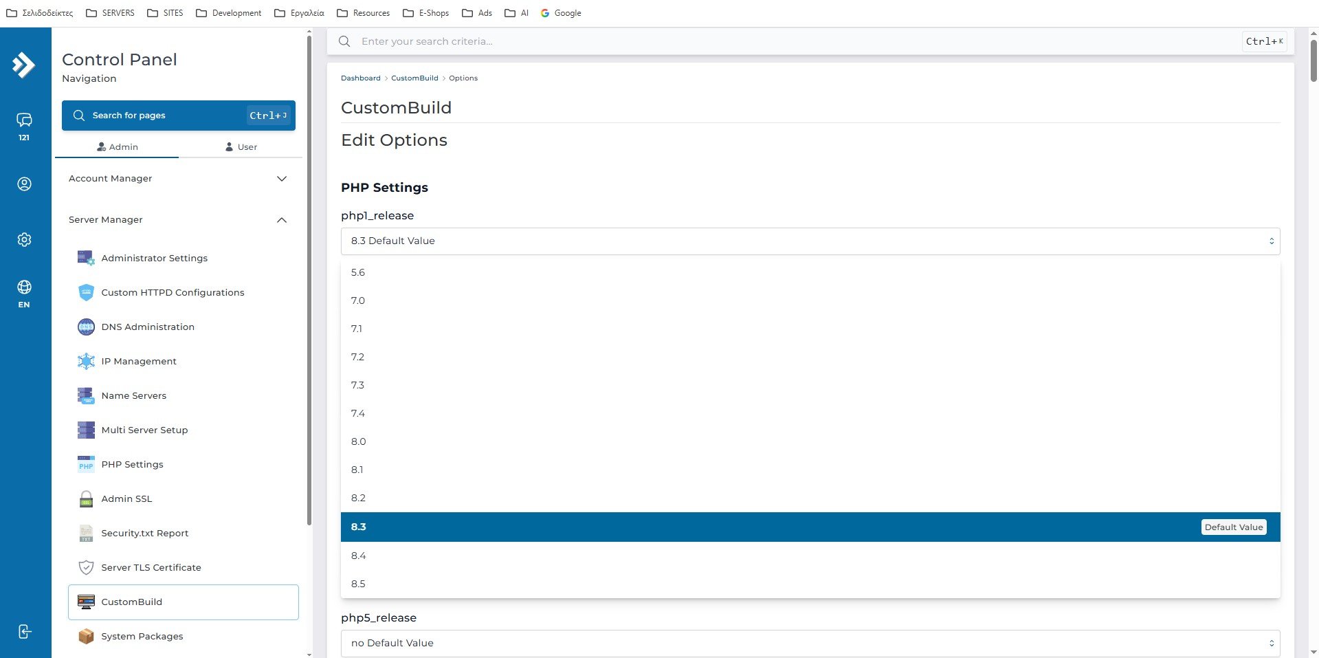

but after finish the setup , i can't see the php selector .. please look at screenshots

The screenshot shows supported PHP versions VS installed. Do you have anything installed as php2_release, php3_release?
In order to have a PHP selector enabled, you will need to install more than one PHP version in DIrectAdmin. The article you are referring to describes how to install multiple PHP versions. You might follow it.

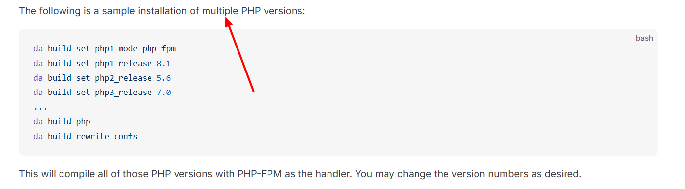

Where that point the instalation multiple PHP version ..? i can't find where he says it .
the same place as you mentioned in the very first post in the thread, i.e. CLI or SSH
In the guide it starts from the words "The following is a sample installation of multiple PHP versions:"
THanks, i find it before but you post faster then me.
