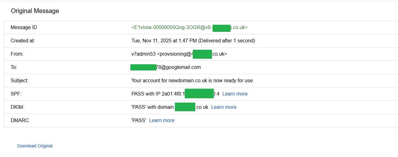

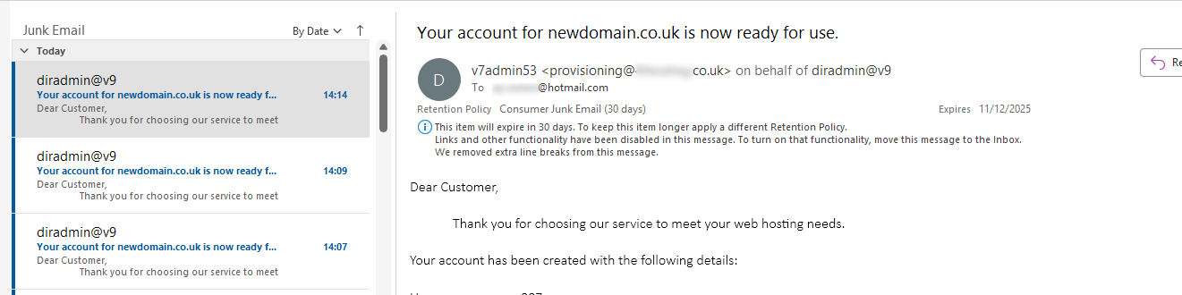

HI, so I changed the server hostname in the name of science and enabled that hook again. Rebooted the server and sent another welcome email. Straight to spam again.
Heres the header data from Hotmail. Gmail the mail went to some black hole again I guess as it never arrived.
With the hostname as part of the sender address, everything failed.

When I change everything back to how I set server up myself, everything passes again. I'll create a reseller in a bit and have a play as I'm always interested in the nuts and bolts of how this all functions.

Your SPF and DKIM are both failing:
Authentication-Results: spf=none (sender IP is 5.9.XX.XX)
smtp.mailfrom=v9.my-domain.co.uk; dkim=none (message not signed)
header.d=none;dmarc=fail action=quarantine
header.from=v9.my-domain.co.uk;compauth=fail reason=000
I would guess that there is no SPF TXT record for v9.my-domain.co.uk
dig v9.my-domain.co.uk TXT
You would need to create a TXT record for v9.my-domain.co.uk that includes an SPF record. Maybe DirectAdmin has a tool that does this? I don't know.
I don't know if you have a DNS zone record for v9.my-domain.co.uk or if you are just using v9 as a third level domain in the DNS zone record for my-domain.co.uk.
The record would need to look something like:
v9.my-domain.co.uk. IN TXT "v=spf1 a ip4:%the_servers_ip% ~all"
I would argue that -all should be used, but that again is going beyond the scope of this discussion.
You probably don't need the ip4 part if v9.my-domain.co.uk is resolving to %the_servers_ip% but I usually include it anyway.
As for making a DKIM key for the server's hostname... I don't know if DirectAdmin has a DirectAdmin way of doing this or not. I never looked, I just create my own.

Basically... DirectAdmin's exim will check the envelope-sender of a message that is being sent out and take the domain part of that email address. If the file - /etc/virtual/%thatdomain%/dkim.public.key - exists, then Exim uses that file to sign the message with DKIM. By default, DirectAdmin exim uses "x" as the DKIM selector, maybe this is customizable? Not sure.
So when the recipient receives this message, it will see that it was signed with DKIM for the ${HOSTNAME} domain with the "x" selector, so it will query DNS:
x._domainkey.${HOSTNAME}
for a TXT record that will have a matching public key. If the signature of the signed message matches the signature of the message with that public key, then the message passes DKIM.
You would need either the SPF TXT record added for v9.my-domain.co.uk. or the DKIM key signing to pass in order for DMARC to pass and for Outlook to (presumably) accept your message as valid. Although, you're always at the mercy of however the recipient mail server (outlook.com in this case) decides to treat your message. Passing SPF, DKIM, and DMARC is not going to guarantee that your message will always go through. But a failing SPF, DKIM, and DMARC is probably going to mean that your message won't make it through (or will end up in the user's spam/junk box).

full_message=$(echo "${full_message}" | sed -E "s/^[[:space:]]*[Ff][Rr][Oo][Mm][[:space:]]*:[[:space:]]*.*$/From: <${USEFROM}>/")
## This sets the envelope-sender to ${USEFROM} - whatever that may be.
echo "${full_message}" | /usr/sbin/sendmail -t -i -f ${USEFROM}
I would probably still just prefer to have all the messages sent from diradmin@${HOSTNAME} and let the chips fall where they may.
And while sendmail_pre.sh allows for a high level of customization here... I still think this should ultimately be fixed within the DirectAdmin mechanism that is sending out these messages.
That's the only way you can send an email from your yahoo.com email address and expect it to be delivered to the intended recipient.

So yes for the time being then maybe it's best to send it from diradmin@hostname.

I would just go back to the very simple solution. Replace the From Header with diradmin@${HOSTNAME} and call it a day. That's what the envelope-sender is set to, so just make it match the From Header.
It's the server administrator's responsibility to insure that ${HOSTNAME} has a valid SPF record and DKIM keys. I posted solutions on how to do that in this thread, but that's really above and beyond the scope that this thread had initially. If DirectAdmin wants to deploy a tool that makes this easier to do, then so be it. But it's not really tied to this particular issue of always using the Contact E-Mail Address as the From header.
