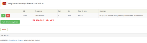

In the screenshots, I may have found a bug with CSF in CentOS7 using DirectAdmin. I can still access the website that's on the server which I want it to ban me.

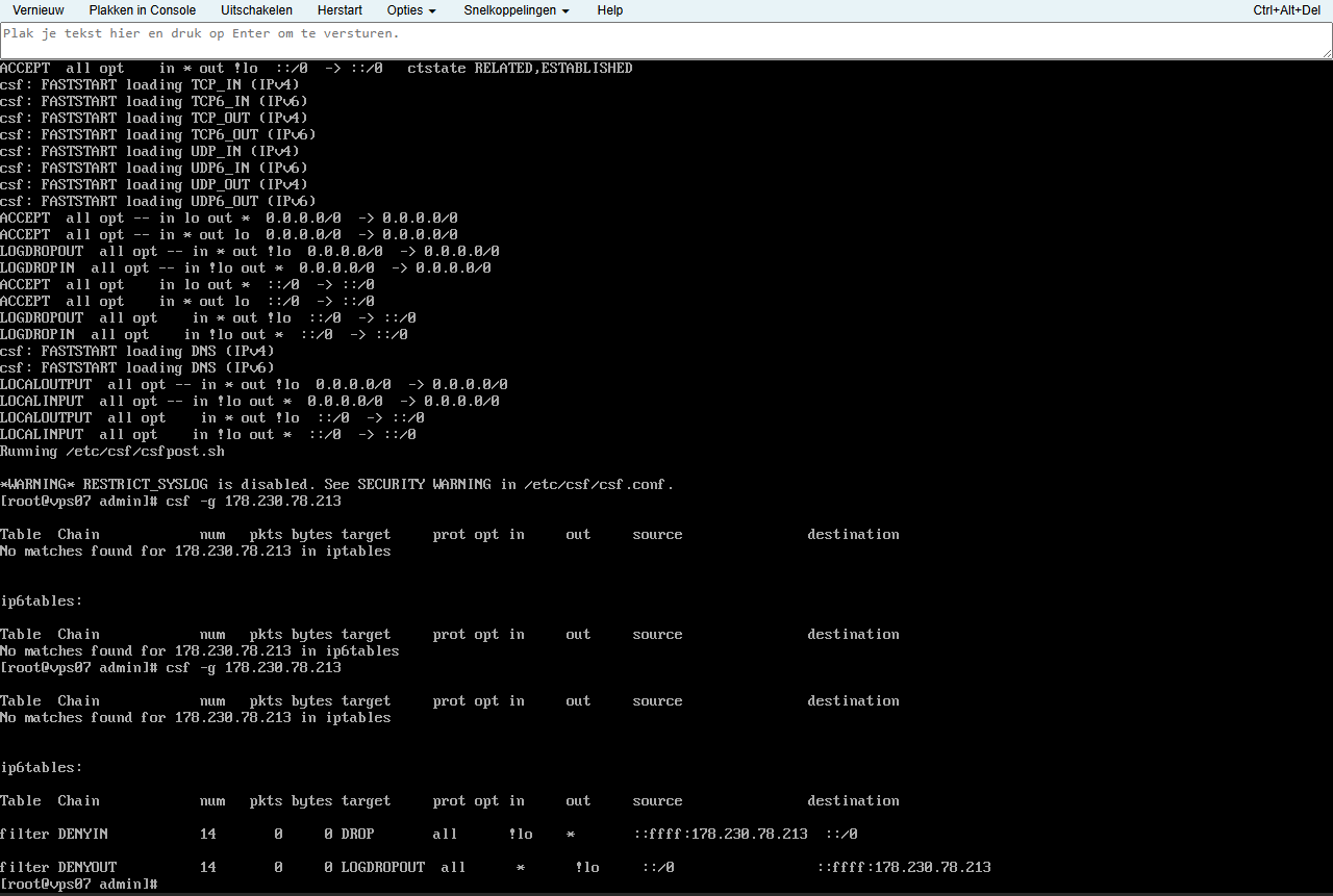

The CT_LIMIT is set at 15, so the IP address got banned very quickly, on purpose, as I want to test if the automated temp bans is working. It doesn't work though. The IP4 address has been placed in the IP6tables as seen in the screenshot above. Not only that, it also uses a translated IP6 to IP4 temp ban as seen in the 2nd screenshot. This only happens on CentOS7 though, and it does not seem to have this issue on AlmaLinux 8, and only if you ONLY have an IP4 available, not both IP4 and IP6

Using csf -d 178.230.78.213 works, I've just tested this. However, using the automated temp ban provided by CSF does not work upon tripping the CT_LIMIT of 15. I have the following values that seem relevant to me for this option:
