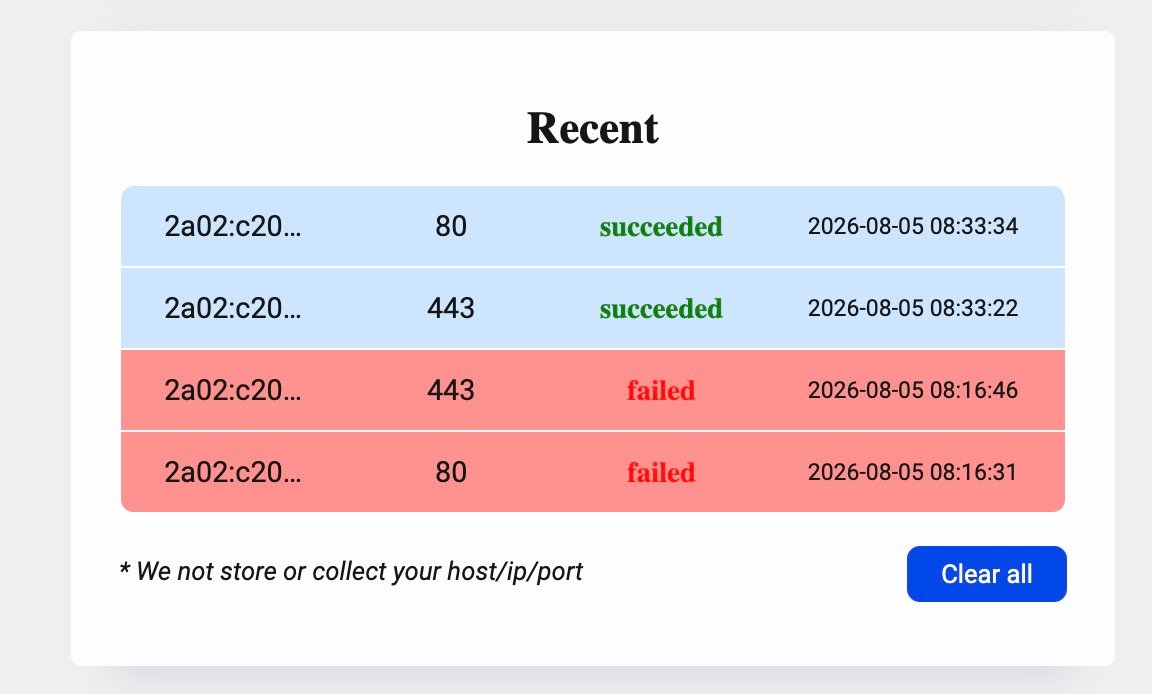

First 30-60 minutes (with reboot) (the green lines = after reboot)

Whell ... that was a surpricing test with Contabo:
  1. I have received 10 answers (tickets) immidiately from Contabo. Untill evening and late at nght.
  2. Spoken to 5 Helpdesk supporters.
  3. I made a MTR and sended images from tests.
  4. Solution: They have made my IPv6 (server IP) to the Contabo Switch.
  5. Problems solved since today 11:48 (dutch time).
So (untill now) this issue is closed. Thank you everybody for your support !!!
